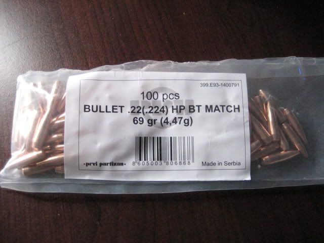

Widener's has these on special, $63 for 500. Made by Privi Partizan. Should be good cannon fodder for the AR's and Sig556
Pup what kinda groups were you getting with the 25.5grns of BLC2 and the 69grns!?SkyPup said:I've been using 25.5 grains of Hodgdon BLC-2 for the Prvi and Nosler 69 grain BTHPs, seems to work real well.
