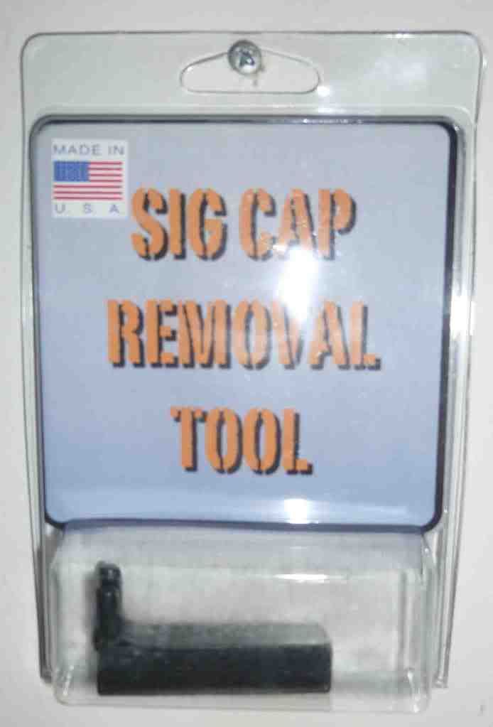

I have a removal tool for stubborn caps.
bmuoio@gmail.com
When I converted my SIG P556 to SBR configuration, I just used a 14-inch pair of channel locks and un-screwed my receiver end-cap; it took me all of three-seconds to do! This is no big deal! To me – so easy to convert to a SIG P556 to SBR configuration – it’s scary! Just get your ATF Form 1, remove the receiver end cap and install the buttstock of your choice, and have the receiver engraved with your name, city, and state; you are good to go!
I wish everyone the best in their business – but – you really do not need a special tool! Just use a pair of channel locks (that you probably already have or can easily borrow from a family member or friend).

Threads are the same. Also, as of late Sig apparently is trying to dispose of their surplus red loctite. My cap was a bear to remove.... the entire threaded area was covered in red loctite on mine.

img]http://i219.photobucket.com/albums/cc250/bmuoio/sigtool-1.jpg[/img]

I used a master link chain #530 to remove my cap on the p556, it was not in too tights.
I wonder where you got the Idea. Very observant.

I also have a 919 Honda and the master link fit very close so it was the first thing I thought of instead of buying a tool. Most of my life, military and cilivian work experiences have taught me there are many answers t o a single problem. The more a person is exposed to in lfe the better they solve issues.

New model and is $45 wrapped $40 without Paracord wrapping.
www.Tacticaltextile.com
